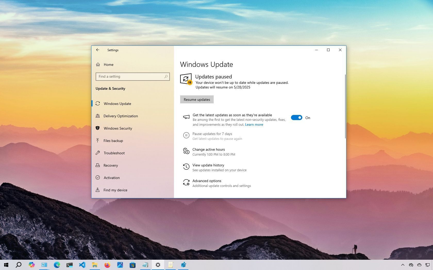

How to stop Windows 10 auto updates
    Yes, it's possible to disable automatic updates on Windows 10, and in this guide, I'll show you how.
